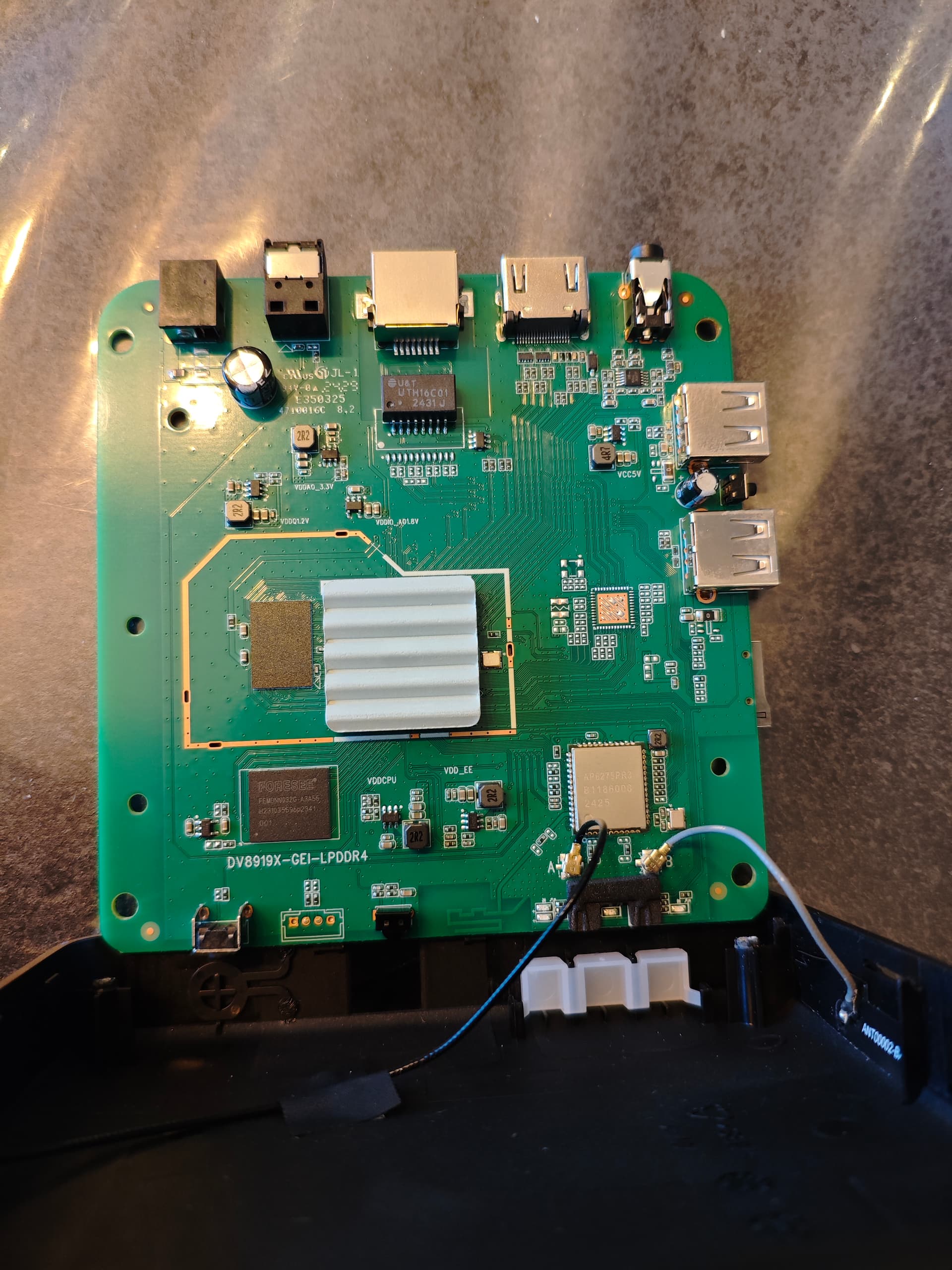

Out of curiosity and various tests, I ordered a Kinhank G1 on Amazon Belgium (€76). On AliExpress, it is around the same price with delivery to Belgium…
The serial number starts with 24800****, so it’s newer than yours.
Contrary to what the manual indicates, there are no batteries for the remote control, but there is a network cable without any certification indicated on it, and it doesn’t seem very high quality (the box was sealed with plastic so I think it’s new).
The build quality of the case and the remote control seems a bit below that of a Homatics R 4k Plus (which costs €129 where I am).

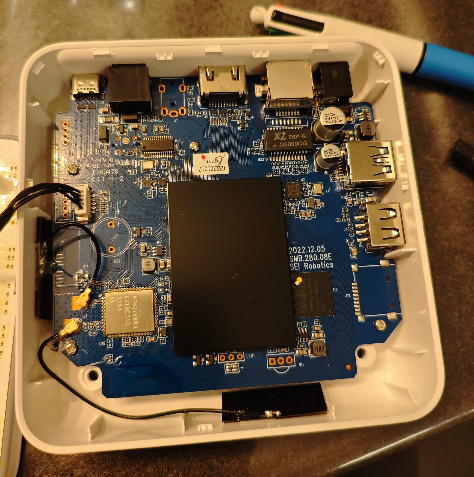

Here are photos of a recent motherboard from the Kinhank G1:
(you can see the reference of the Ethernet chip, UTH16C01, which is a 100Mbps reference. So they didn’t include a recent 1Gbps chip ^^
And those of a Homatics R 4k Plus:
I will try to start the box directly with CoreElec NG nightly 20241021 and the file sc2_s905x4_kinhank_g1_new_revision.dtb on a 64Gb Integral Courier USB 3.0 flash drive.
We’ll see if it launches or if the firmware with a locked bootloader is already installed before the first startup…
Then I will test on Android TV 11 if all audio formats pass through well and if Dolby Vision and HDR work well on Netflix, Amazon Prime, and Kodi.
