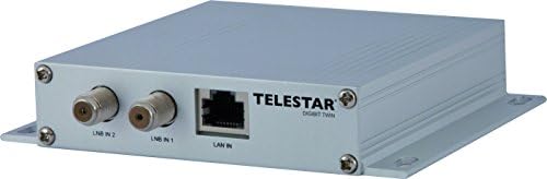

A SAT>IP box is about the cheapest way to get two tuners. These are far more reliably supported than many of the cheaper USB tuners they are up against.
There is also a two tuner version, but it doesn’t fully support the SAT>IP protocol which can make detection erratic.
Cost wise there is no other option which will get you 2 tuners for €74.00
The real beauty of SAT > IP is it is platform agnostic, just so long as TVHeadend supports the protocol it will work on any hardware.

If I am mistaken please can fix, Telestar and just DVB-S?
So I will be limited, correct.

The Digibits do both S and S2. Its extremely rare for a tuner to also support terrestrial, but terrestrial USB tuners are cheap as chips.
