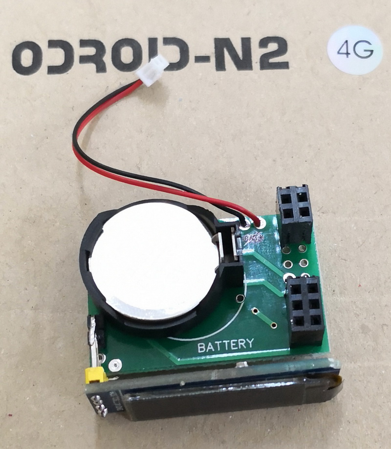

I want to remove it from the pcb and turn 90 degree up and then I can cut a narrow gap on the top of the case for this.
That’s an SPI module isn’t it?
It’s SPI or parallel. In current config like pictured is parallel.
I don’t know which controller that display uses, but these types of displays usually require the 3 SPI pins + 2-3 extra GPIOs.
It uses SSD1322. The modul can drive with 3 or 4 wire SPI and 8 bit parallel. I’m thinking to make a pcb with all the wires connected, so you can decide which mode you want to use.

@startv could you post a side photo I’d like to see how the oled attaches to the pcb.
