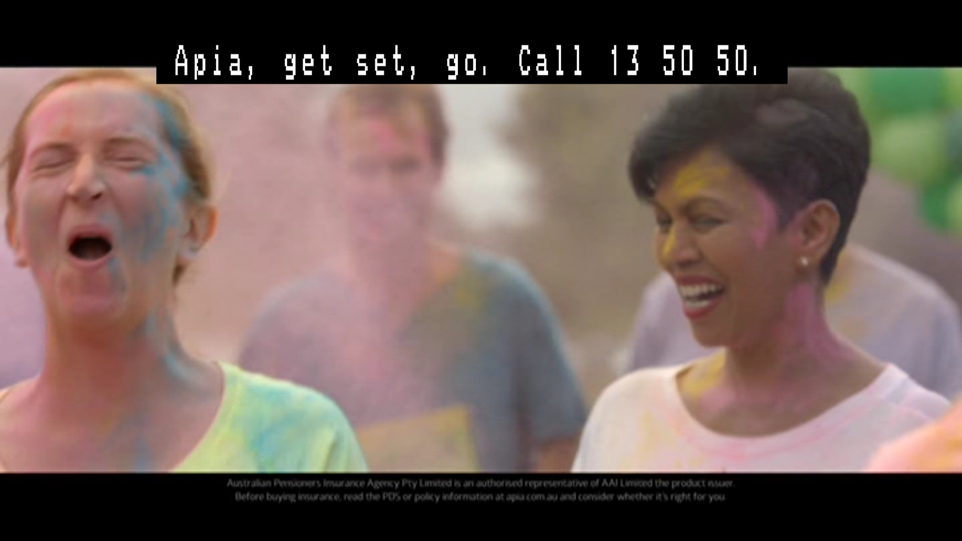

I just said that if you take a screenshot of this video and you zoom in you can see the bad downscale.
I’m sorry but I’m not understanding what you are saying. You have the video of the recording so you can do with it what you want. So can’t you take a screenshot of the video if that’s what you want.
Sorry if I’ve got this all wrong.
I did that (screenshot + zoom). This video is SD, bad quality and the text size is small so it is normal that you can’t read the text.
Basically, he’s saying that because it’s from an SD source, you’re never going to get a very crisp picture on an HD screen, and that your TV will likely able to upscale it better than CoreELEC (due to the fact that CE has to do it in software).
To go about using your TV’s up scaling, you’d need to “whitelist” the resolution, so that CE knows that it doesn’t have to try and upscale it. The whitelist is in Settings->System->Display.
