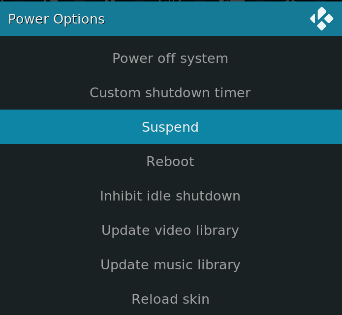

And what wakeup method?
after suspended, I press remote’s power botton , HDMI no signal ,network also can not be connect, only the power led lights, and I also tired power key(the gpio pin#31), the same.
