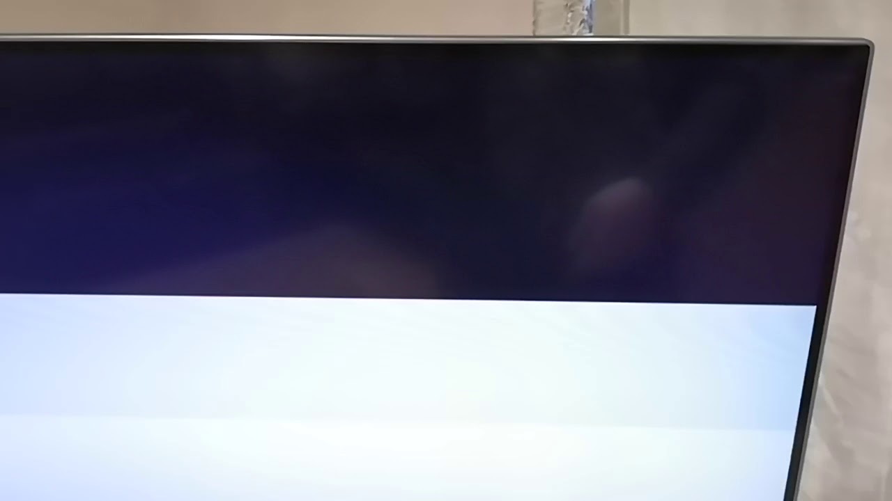

Ok just tried a old Kingston HC card, 16gb
On same Q6 TV with same setup I donât see any connected coreelec message.
Apart from been really slow at loading due to card speed it seems to work fine.
Put Samsung back in and coreelec connection message pops up but I can still watch movies and It only looks like it says that message the first time coming out of suspend, turning TV on and off again to put N2 in suspend doesnât bring up the message again.
EDIT: itâs hard to see the exact message as the TV has a big white bar with info running along the top of the screen when booting. From what I can tell it has just popped up coming out of suspend mode for first time after reboot saying something about disconnecting? and then a message saying successfully removed storage system coreelec. Again everything plays ok.
EDIT2: Seen message a bit better this time,
âsuccessfully removed storage device, coreelecâ
then
âmounted storage device, storageâ
These happen one after another and very quickly.
Definitely only get the message after first reboot, after that going in and out of suspend dosent give any error.
