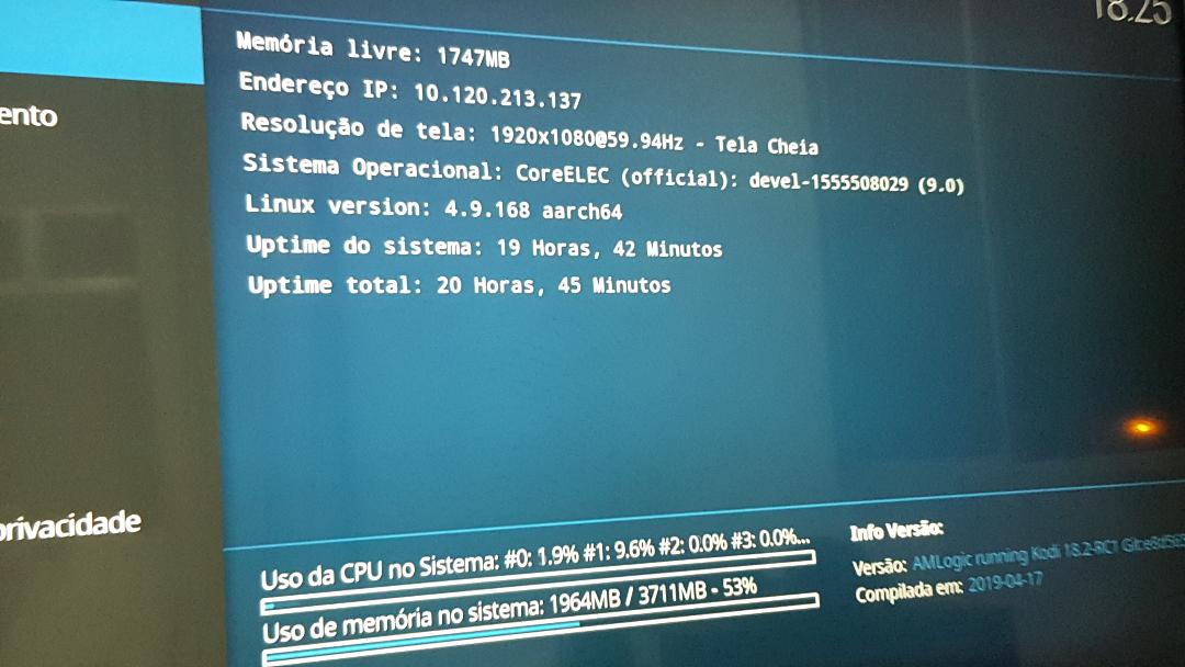

I’m using a 16gb sandisk SD and it works great, even when it suspend.
but the memory usage is high. I’m using the same addons I used in C2 and it was only 500mb
