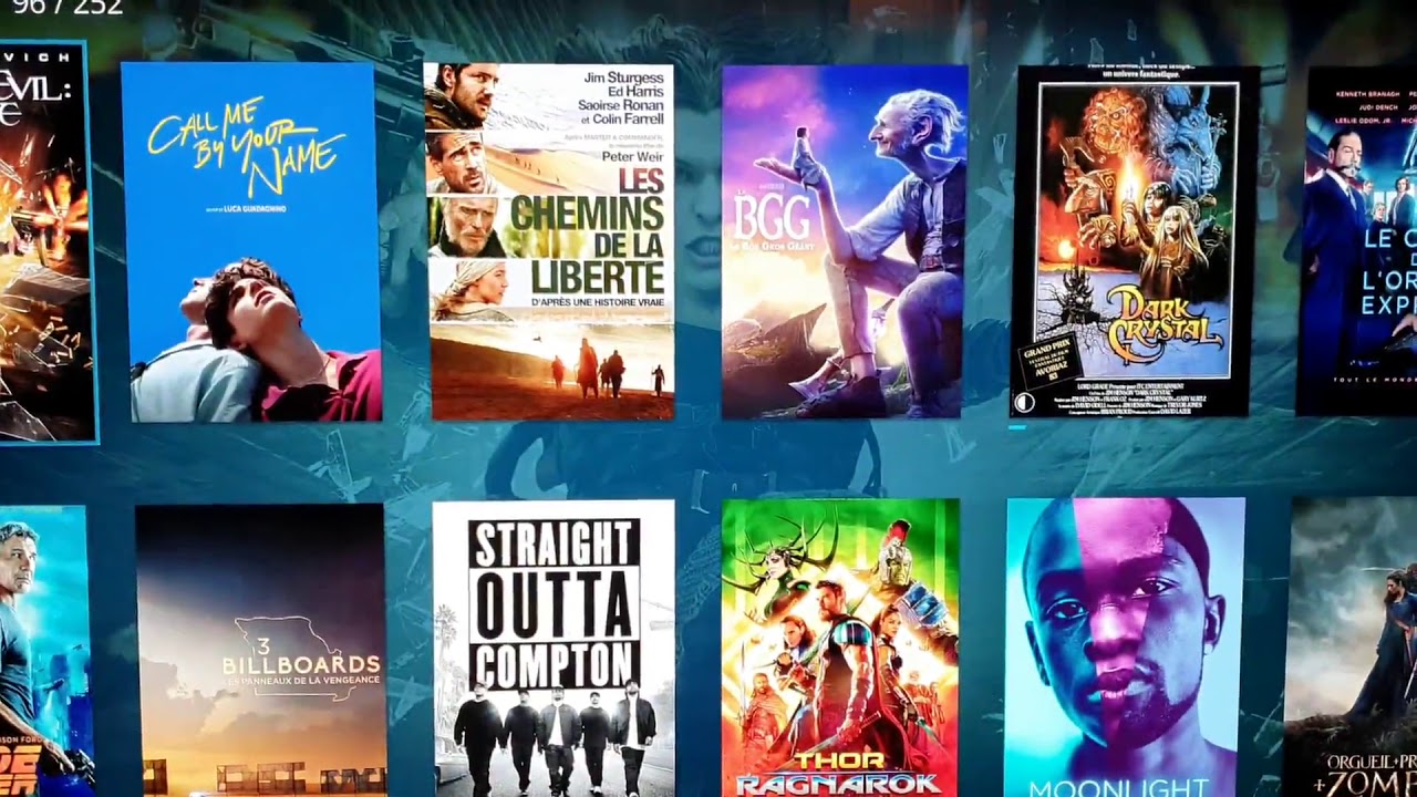

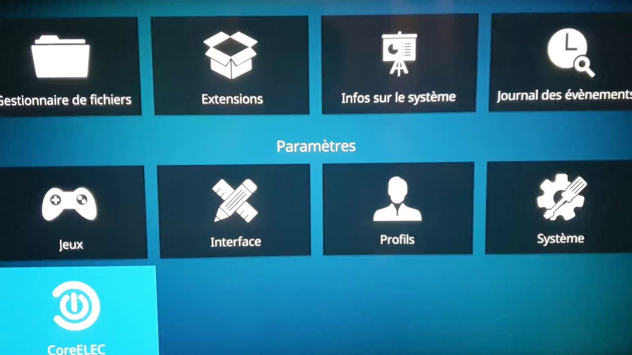

2 videos, for 2 different motion effects.
In each of the videos I apply the same effect to 2 different places, one where there are a lot of covers and which slows down, and the other one or the S922 does not slow down. I think we should be able to optimize the GUI to stay at 60 FPS everywhere.
Feel free to watch several times, without âmotion compensationâ, and on a screen with low remanence preferably. (I have the impression that on an LCD is less obvious than an oled.)

First video:
The first 7 seconds we clearly perceive jerks, we guess a framerate that should be around 30 FPS. Then itâs more stable, we see the movement as a whole (itâs less painful to the skull), we are close to 50 FPS. Our sensibilities are surely different. But I see that the screen is important. I recommend an oled screen for better viewing.
It is obviously more visible in ârealâ.

Yes thank you, I just try. But the most embarrassing is especially during the âscrollingâ covers. (Video 2)
But the covers are so beautiful in 4K, Iâll leave like that, it does not matter.
