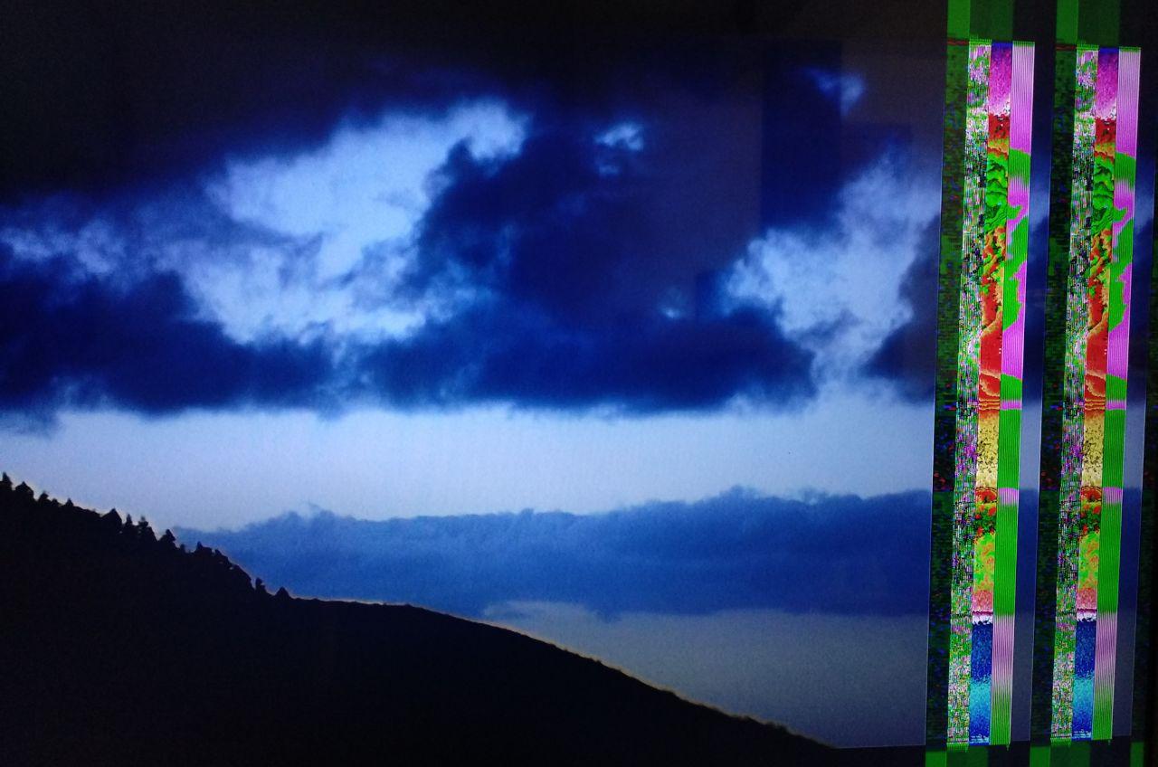

Hi. Before this commit https://github.com/CoreELEC/xbmc/commit/45d0edc3ccce738405e475b073129958e34f3d4d (I think), VC1 was unplayable.
Now it works well, but I get this:

VC1 is broken inside the closed source blob from AMLOGIC. I’m working closely with Hardkernel so we can resolve this. First I’m working on a huge Amlogic upstream update in kernel. Maybe it will fix it. If not we will try to talk to them.
It looks like talking with Amlogic is not easy…

Can you post a sample of this video please?
I’ll try, but it will be a small sample because of my ADSL
Uploading to Google Drive.
Something strange happens. On this way, it works perfectly:
(In English, I think it’s “Play to” from Windows to CoreELEC.)
If I play directly from the N2, the green bars appear. I’m confused.
