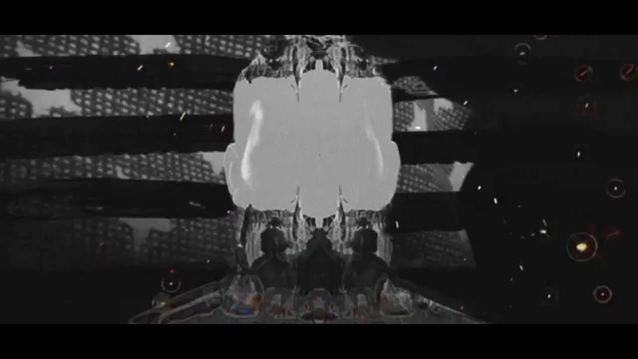

Spoke a bit too soon but almost there haha
Only issue I am getting is in a 2160p vp9 from the YouTube add-on, showing the same garbled screen as previously but everything else is fine.
It is the 4k Digital Foundary vid for A Plagues Tale uploaded yday.
