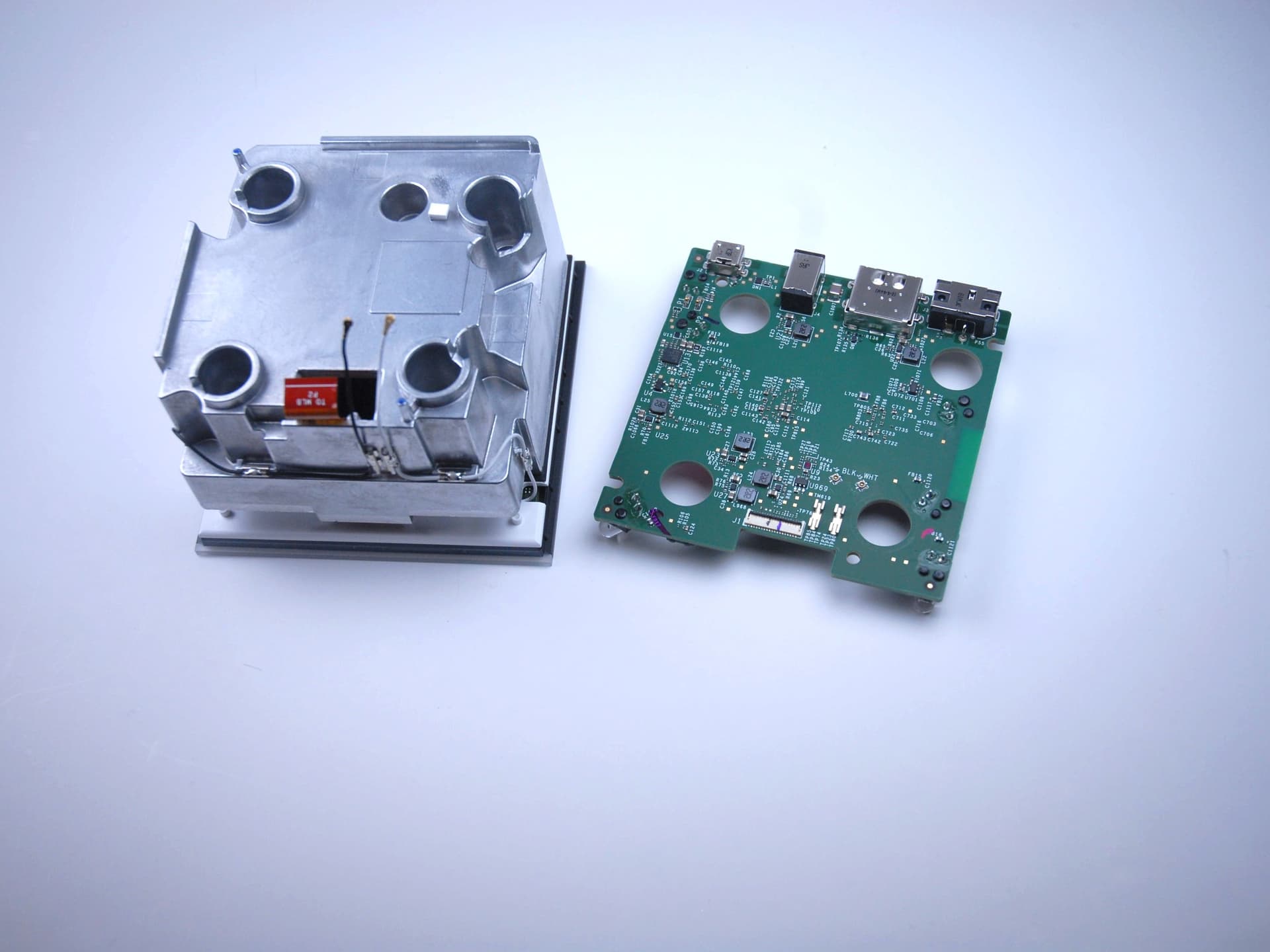

The Cubes and Odroid N2/+ do have the best passive thermal management of any AML devices.
The heat sink is most of the internal volume (and why the Cube weighs 2x the AM6+). Most Amazon flag-tier devices have very good build quality despite the shortcomings of FireOS.
