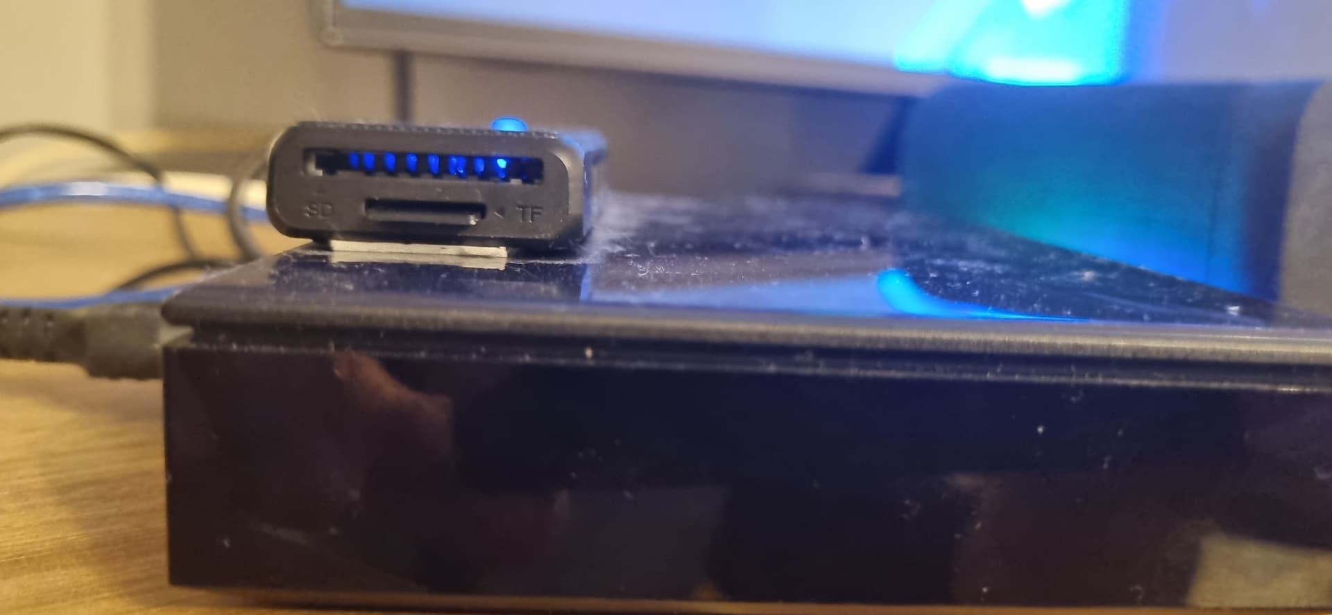

I also run it with SD card using USB multiplexer.

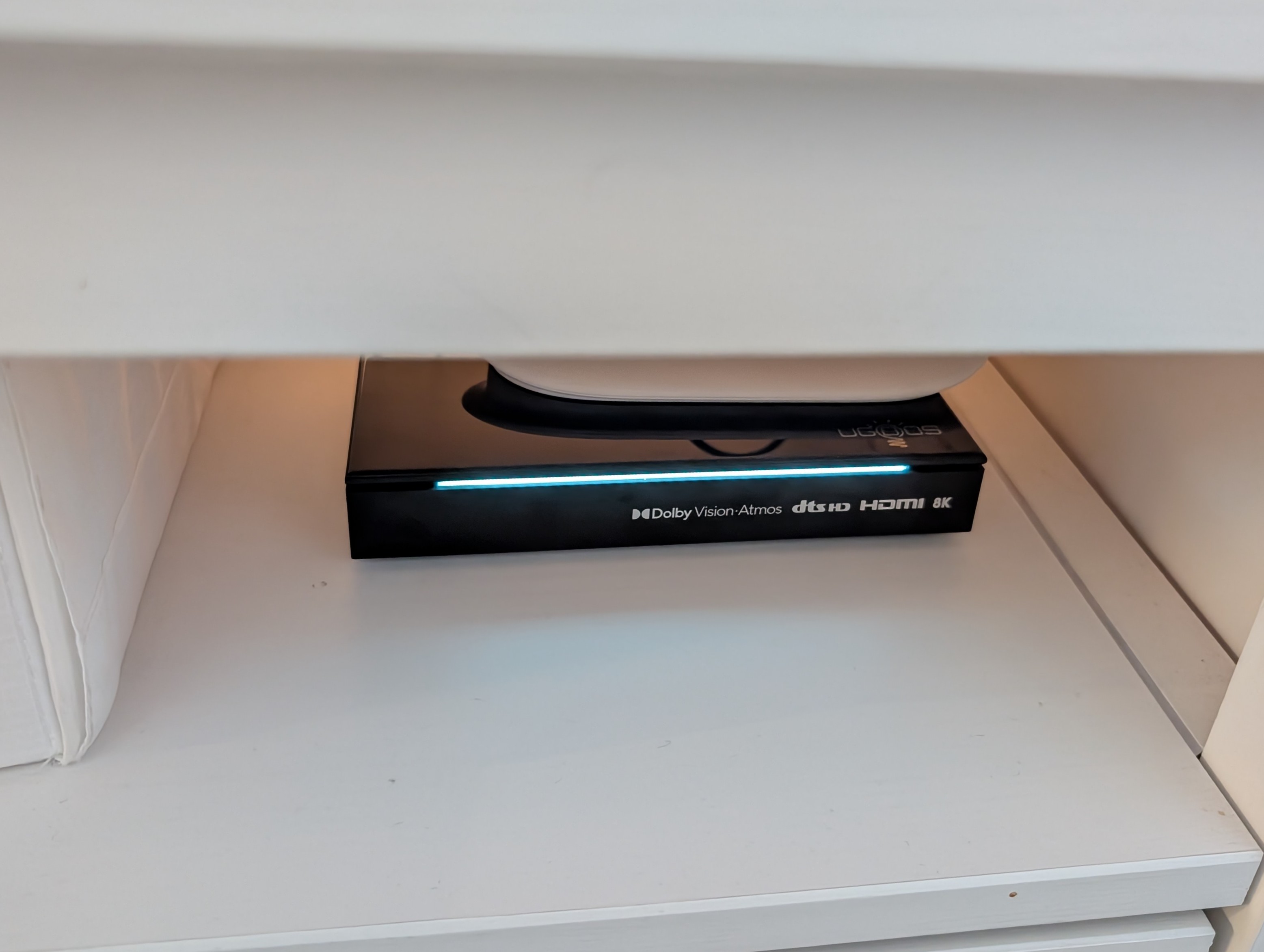

Hi, I just received my SK1 and configured Coreelec on it (on eMMC) and it works great - I’m extremely happy. Anyone figured out how to change or disable the LED light on the device?
I’m just checking how to make it work. But you wrote ā€œdisableā€? Is LED visible when CE runs?
Can someone write what works and what should work?
I’ve put a black tape on it as Peter advised in some post a while ago :stuck_out_tongue_winking_eye:
Yes - and it’s quite bright :sunglasses:
Which means the LEDs are all on by default.
You can try to set it off with SSH commands
echo 0 >/sys/class/leds/strip-red/brightness
echo 0 >/sys/class/leds/strip-green/brightness
echo 0 >/sys/class/leds/strip-blue/brightness
Instead of value 0 you can use any value between 0 and 127 and set custom RGB color.
Thanks @vpeter - that worked like a charm!
To make changes permanent put commands in /storage/.config/autostart.sh.
A post was merged into an existing topic: Amlogic-no Discussion
@vpeter Thank you very much, I can remove the black tape now :smiley:
