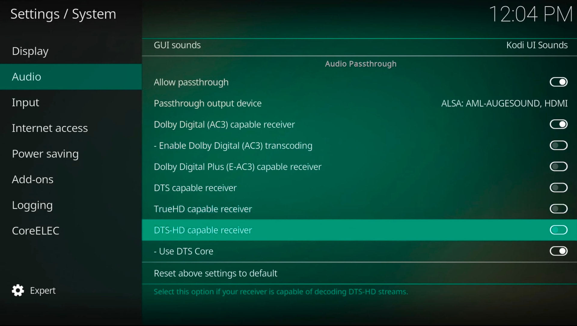

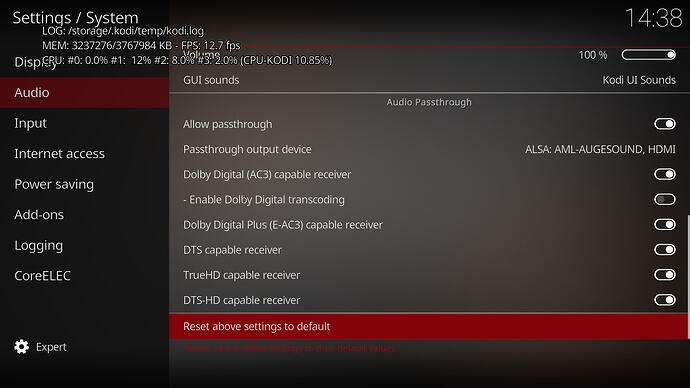

Take the picture of your settings :
:backhand_index_pointing_up::backhand_index_pointing_up::backhand_index_pointing_up::backhand_index_pointing_up::backhand_index_pointing_up::backhand_index_pointing_up::backhand_index_pointing_up::backhand_index_pointing_up::backhand_index_pointing_up::backhand_index_pointing_up:
You sure it’s enabled?
Well,my only guess is,if you have all audio pass-through settings enabled,you restarted your devices,still nothing,well,my TV has 2 different audio output settings,multichannel and multichannel pass-through,with multichannel setting enabled,it would pass-through only 5.1 multichannel PCM,also I noticed,when playing 5.1 channel pcm video sample,my TV would detect is as Dolby True HD, so probably your soundbar can’t decode Dolby True HD,it detects 5.1pcm as DT HD.In android SK4 can decode DT HD and output it as 5.1pcm.
