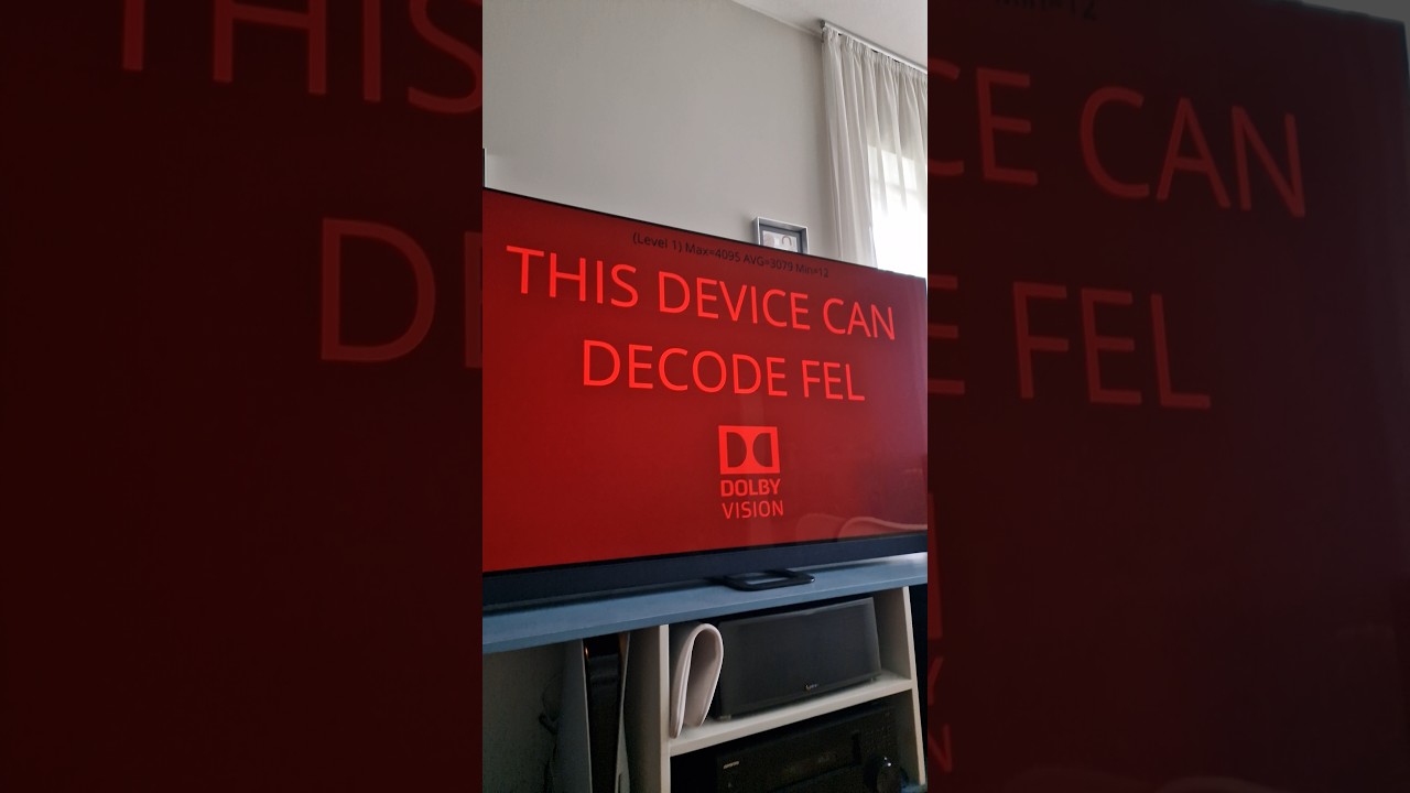

Both SK4 and SK4 Pro can play Dolby Vision profile 7 FEL with CE22
Kindly share what build you have used for this to work?
Latest CE22 nightly and the dovi.ko attached here?
Thank you
