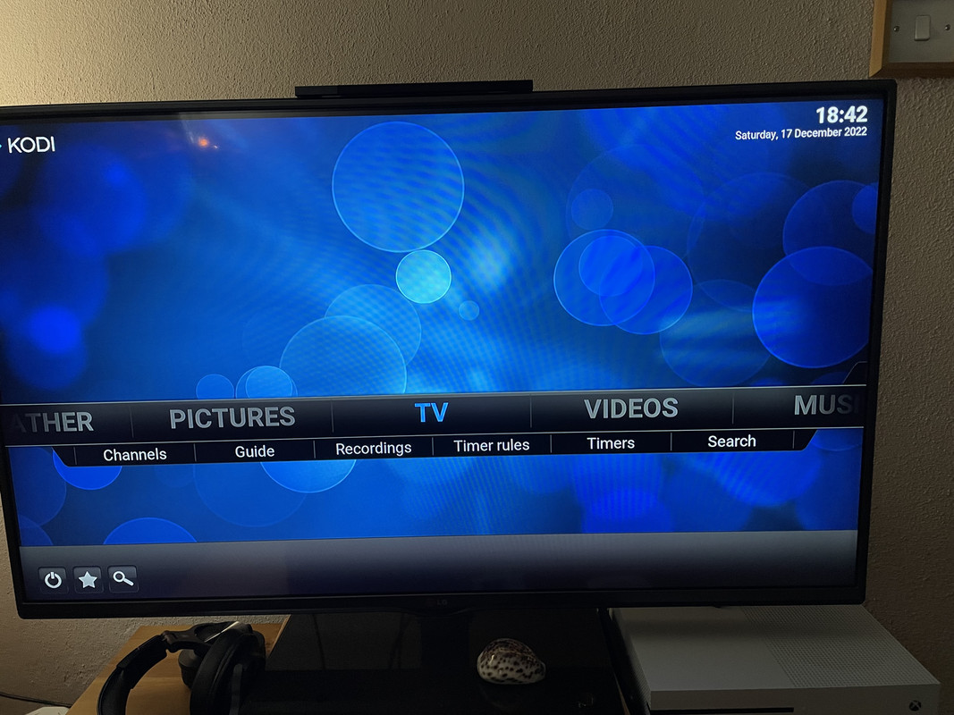

@sebus05 if you say “live tv tab” is missing it means you’re not using the default skin, right? Please try with estuary and report back.

I am not using default skin, but that has nothing to do with it, because the Live TV tab is missing most of the time (but NOT always!), sometimes it does appear

I mentioned it because on estuary the tab doesn’t disappear, it’s always there and it would be easier to debug the problem. If you don’t want to try it so we can check if it’s a skin problem, that’s ok. Provide logs following this coreelec:ce_support [CoreELEC Wiki]
