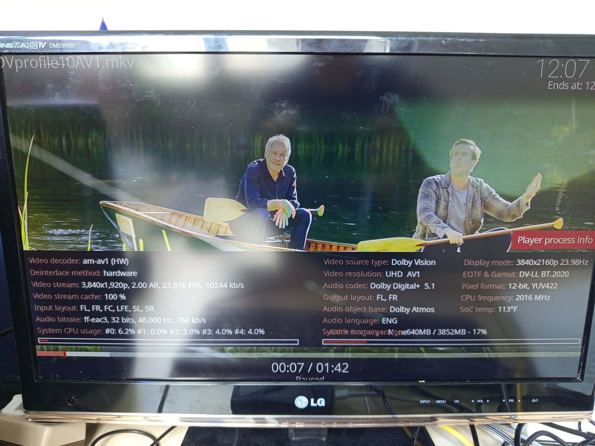

Some linux based devices 4.9 recently got a fix to play the new profile 10 of Dolby vision-AV1.
I guess CE will never update those under NG as it’s considered EOL
Dolby Vision in AV1
Video sample. (Newly added and not commonly used nowadays)
Same goes for HDR10+ in AV1, but a bit better as it falls back to HDR10 while DV sample gives a black screen
HDR10+ in AV1
Intersting. I can play those on a non dolby vision tv
Next week with CE-NO DV profile 10 should be supported.
