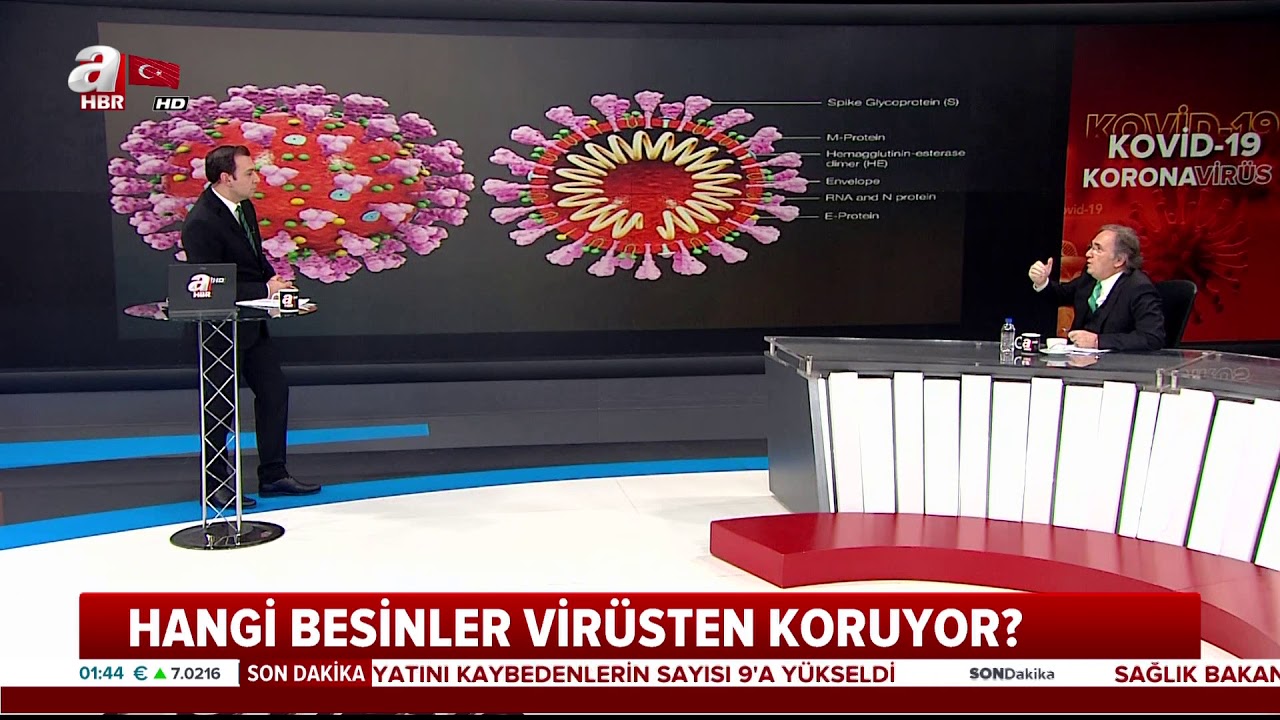

Intermittent freezing on live tv images continues in GT king Pro. But there is no problem with sound and recording.

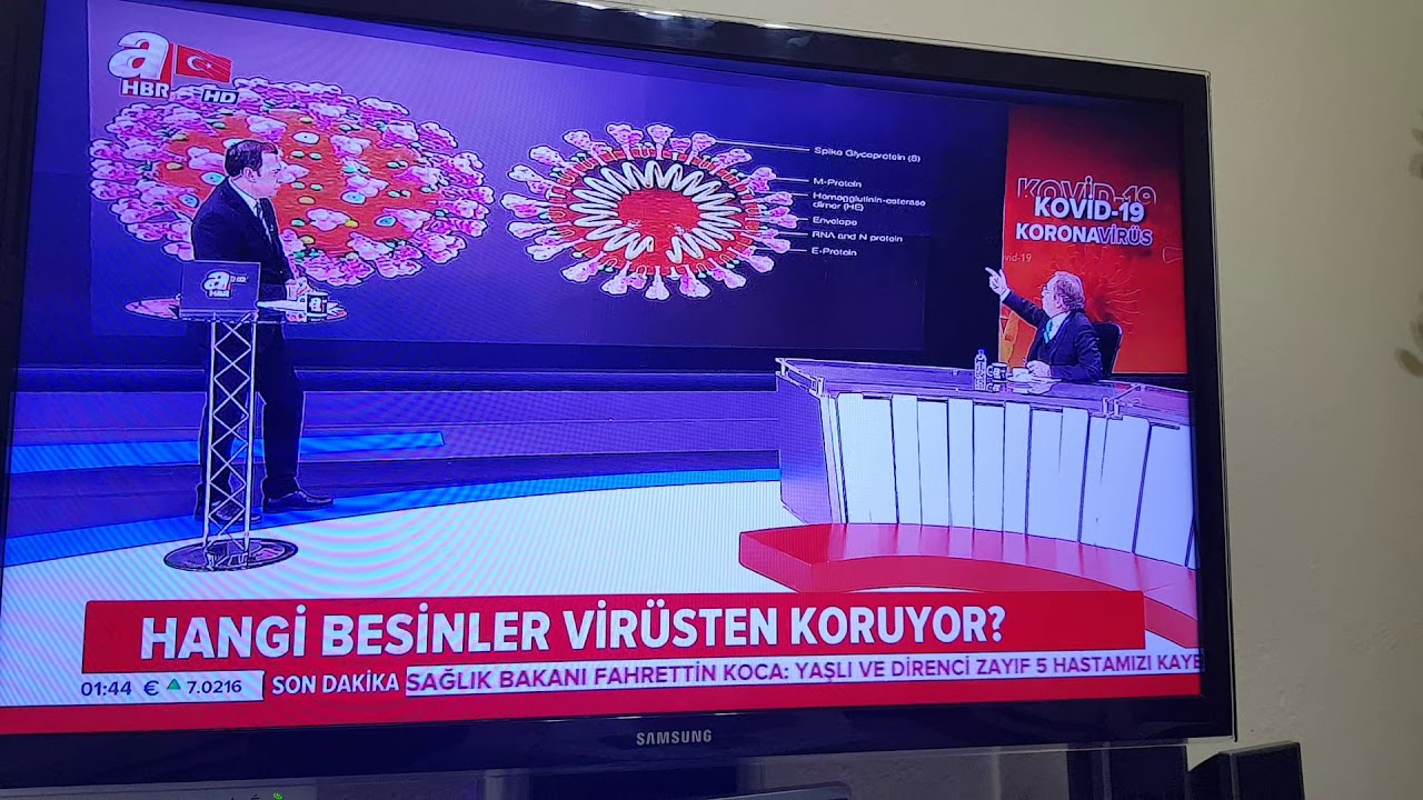

I have the same problem with the TBS5520SE and with avalink 6862 ki pro.
KI Pro with nightly-builds same problem small locks.
HD channels only.
SD channels work perfectly.
Yes,No problem with 4K channels.
