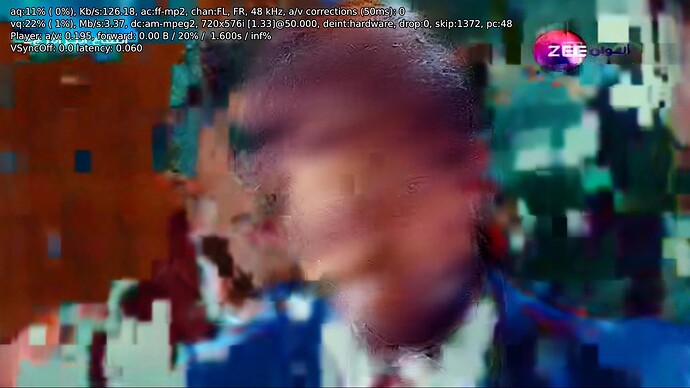

Thereās an issue in some SD (576*720) FTA sat channels
that two errors keep showing in kodi.log
CPtsTracker: detected pattern of length 50: -140000.00
CPtsTracker: pattern lost on diff 20000.000000
when that errors become like this:
CPtsTracker: detected pattern of length 1:
20000.00,
the picture become clear
kodi.log (7.6 MB)
mecool ki pro s905d
@Portisch
is it a kernel related issue?
Donāt think so
This problem occurs perhaps every 20 minutes or less and disappears when the channel is stopped and then started again.
It also disappears when hardware acceleration is turned off
