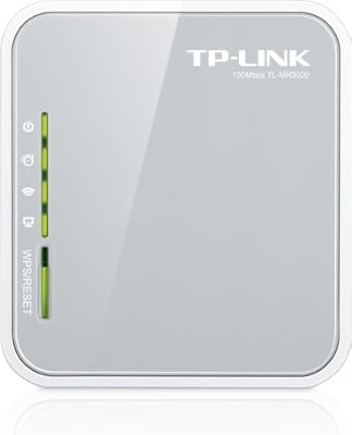

Guys is there any usbethernet or usb lte dongle support in CoreELEC? Usbethernet I mean usb lte sticks that gives address over dhcp to the hosts’s usb0 (as an ethernet interface).
I have two USB-LAN adapter, they works well with CE.
Never tried USB mobile stick but I guess it will not work without setting up it properly.
An option to make this work would be to buy a router with a SIM Card slot that has an ethernet out. Something like the below:
oh. it has :smiley: guys you are awesome.
